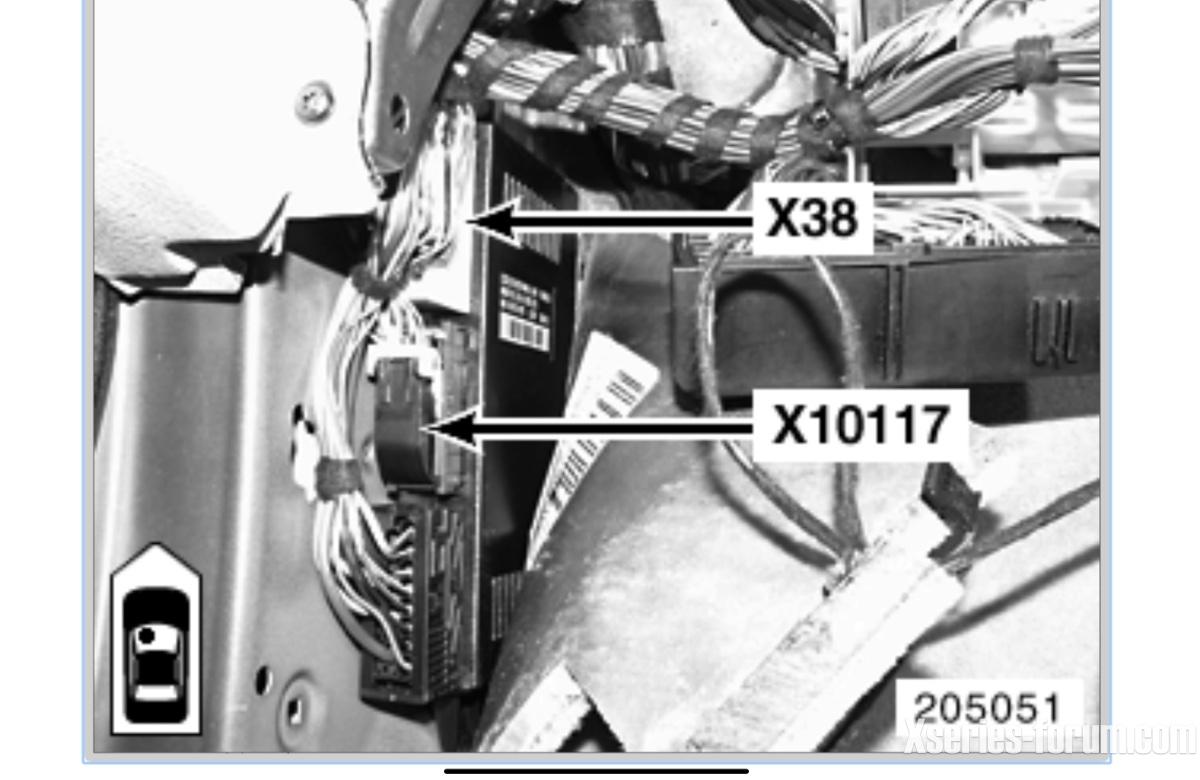

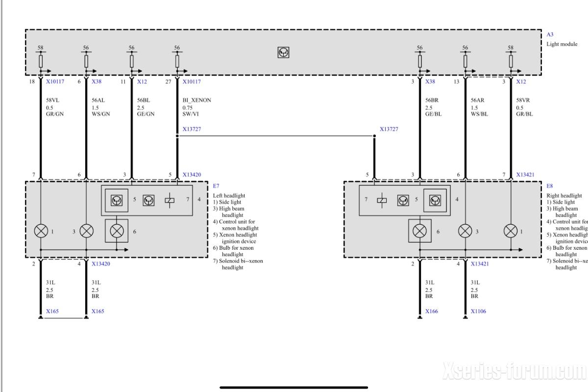

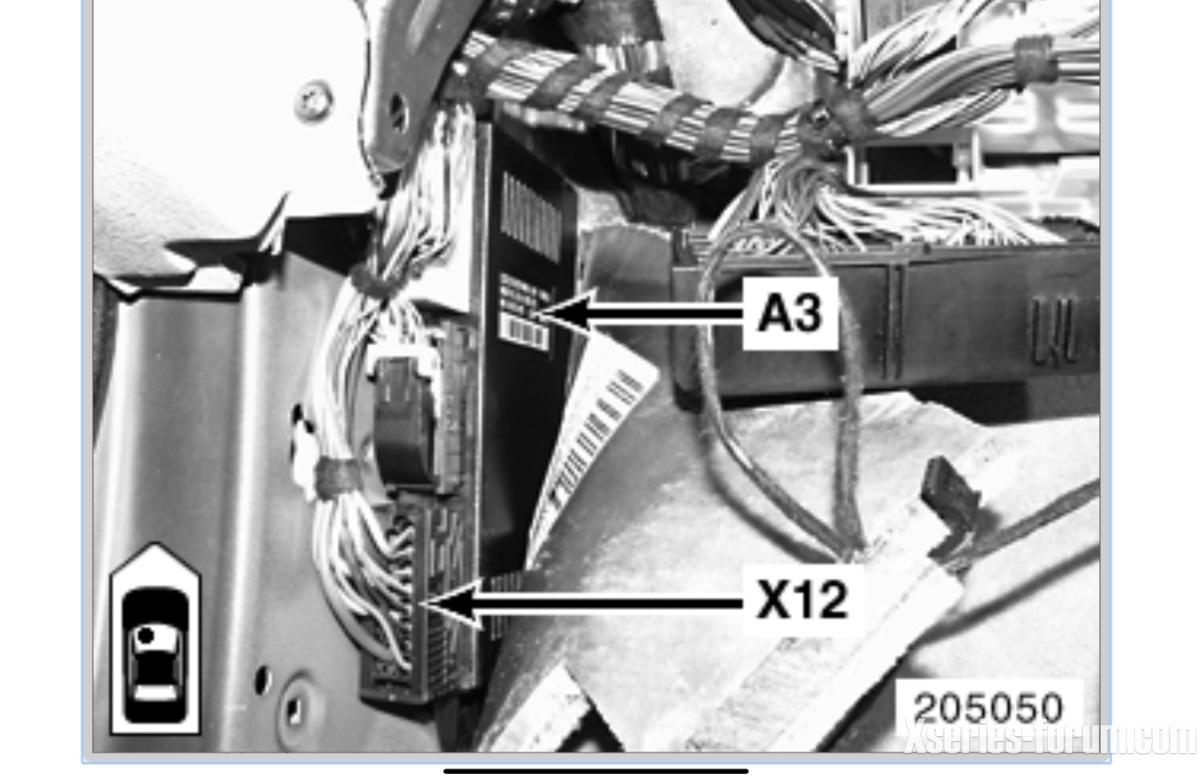

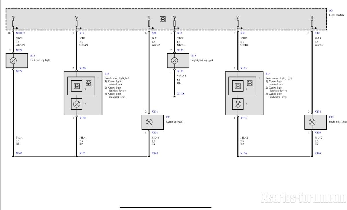

Looking at the wiring diagram, both lamps are separately wired directly to the Light Control Module itself. No relays or fuses. The LCM is shown as the left side A-pillar footwell area. Power feed is to the LCM itself.
Wiring to the lights from the LCM. Both sides are separately grounded to chassis. Two wiring options - below- the lower one looks to be for the E53 LCI (09/2003 onwards) but I’ve put both up.
There is an alternate wiring diagram as well……

Just updated the diagrams to first post - two versions, lower is probably what you should have. Aftermarket kit could well upset the LCM but the two sides have separate feeds as do the high beams.
Connectors…….
X13nnn series connectors are on the lights themselves. Wire colours are in German. You’ll need to translate I suspect.
There is one common feed to both sides, and that’s the high beam shutter driver for the HID pair. It moves at the same time as the high beam pair turn on assuming BiXenon lights (I think I had those on my 2005).
