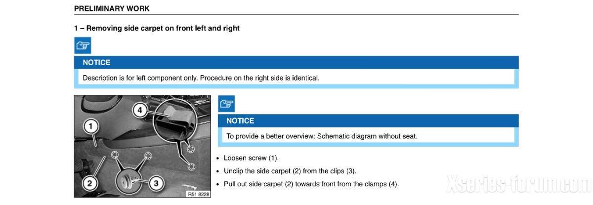

I’ve now moved it and tapped off the cigar lighter feed when I replaced the Roadhawk 2 with a Nextbase 622GW (needs a bit more power). You can get to it by removing the trim above the pedals (4 screws) and you can see a screw that holds the transmission tunnel side trim at the forward end. Remove the screw and carefully slide the trim forwards. The 12V socket feed is Green with a Red tracer on mine. The power supply for the Nextbase is just resting in the trim above the pedals.
