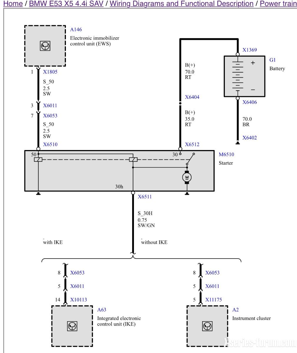

Post by X5Sport » Sun May 14, 2023 9:24 am
If all they did was change the starter, that points towards bad wiring (or they forgot to reconnect something). End to end check will find out. Wiring for starter motor & relay (top), Starter motor option 1 (middle), option 2 (bottom). Not a lot to check.
