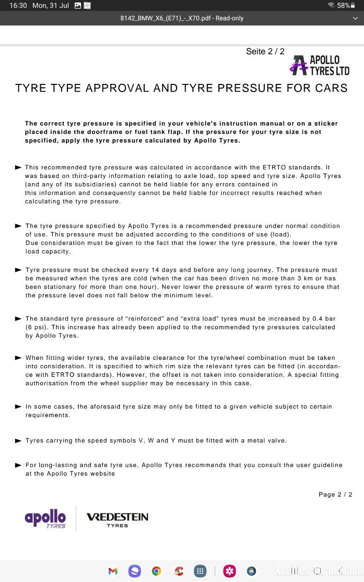

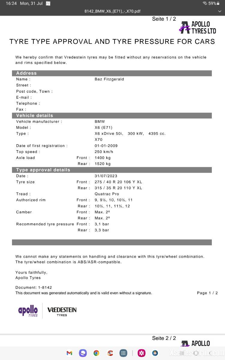

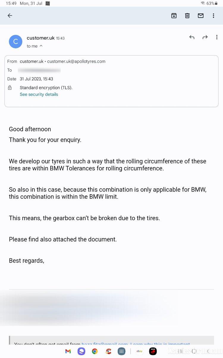

Further endorsement from a much earlier post from the makers, that these tyres are matched for use on BMW. Wrong engine is noted but ill not bother on that.
I have way too many sets of wheels, its time to rationalise. All weather is the obvious solution. I'll keep the full winter spec Pirelli's for the time being, just in case.

Interesting. Might look at their Wintrac set. BMW are using Vredestein as one of the OEM options. Getting them in 19” fitments has been the problem I’ve faced. My winters run on 19”, Summer in 20”.

I think im on record as saying that i view the ☆ system with some scepticism. Any excuse to walk away and blame something other than your own engineering is pretty pathetic. Mashed gearboxes because ot tyres is not an issue, afaik with Land Rover. They however have plenty of other things to deal with.

Agreed. Even in the handbooks it says ‘recommended’ as I would suspect if challenged BMW might find that could be an unfair contract if they insisted but I have read of instances where they’ve walked away. Having the courage to test that is the opportunity.

sapphireblack wrote: Mon Jul 31, 2023 6:20 pmMashed gearboxes because of tyres is not an issue, afaik with Land Rover. They however have plenty of other things to deal with.
IMHO, the difference is that Land Rover products (well, at least the ones with the engine and transmission the right way round.......) have a centre diff rather than a transfer box.
