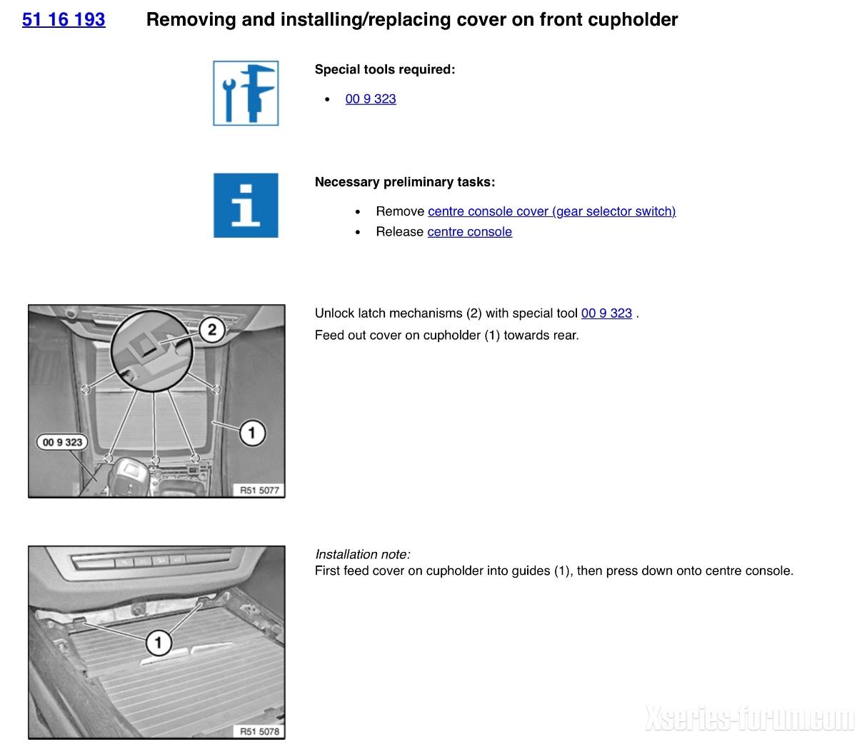

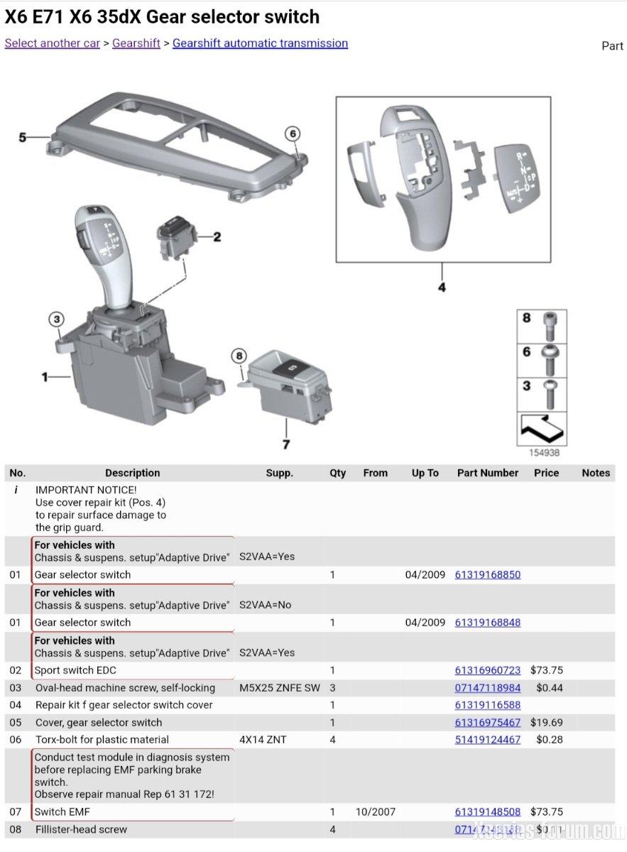

Is there one?
TIS was great though i used it infrequently. i can't find anything that seems to ' replicate ' what was once available.
I would like to obtain the RHD version of #4 to start off with, which is circa £90 😲 for a genuine part on eBay. If the P and perspex panel weren't compromised i could have bought a black or even a coloured frame, lots on eBay.
i'd also like to see what is involved in accessing the side decor trims with the knee pads.
Screenshot_20230917_075637_Samsung Internet.jpg (115.3 KiB) Viewed 10531 times

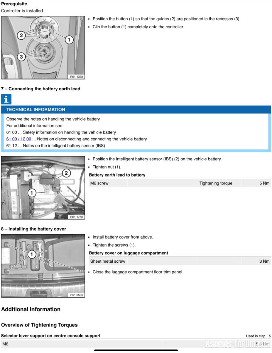

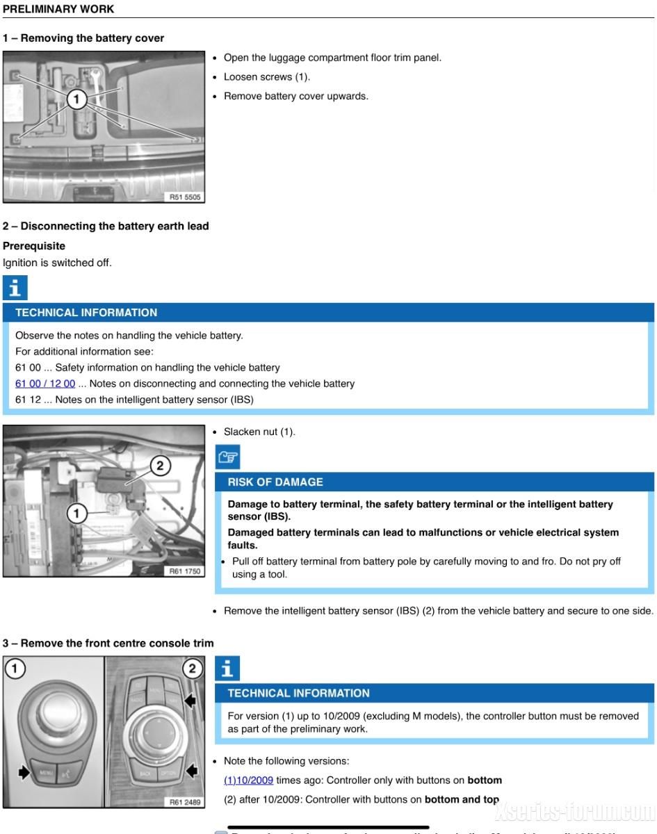

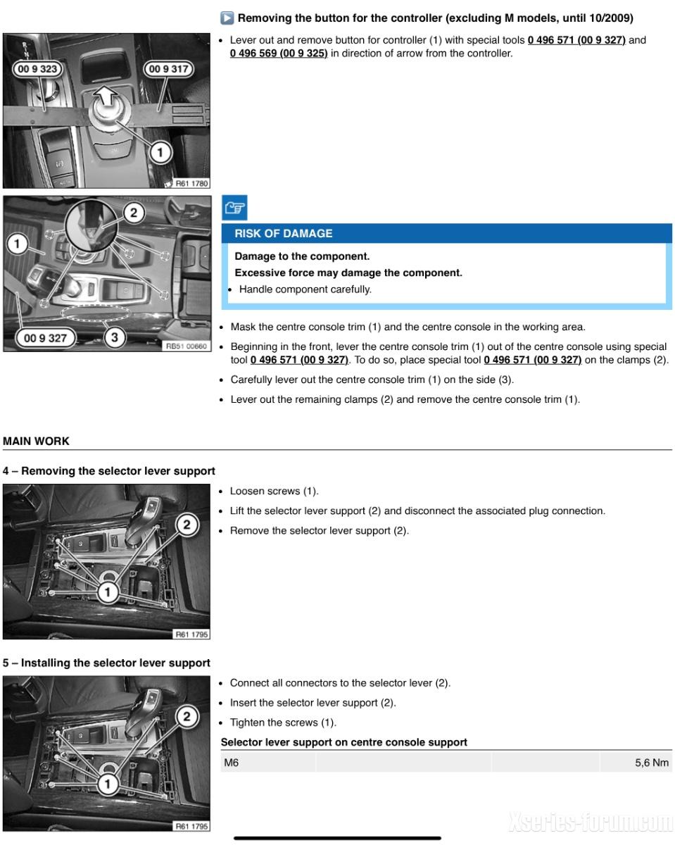

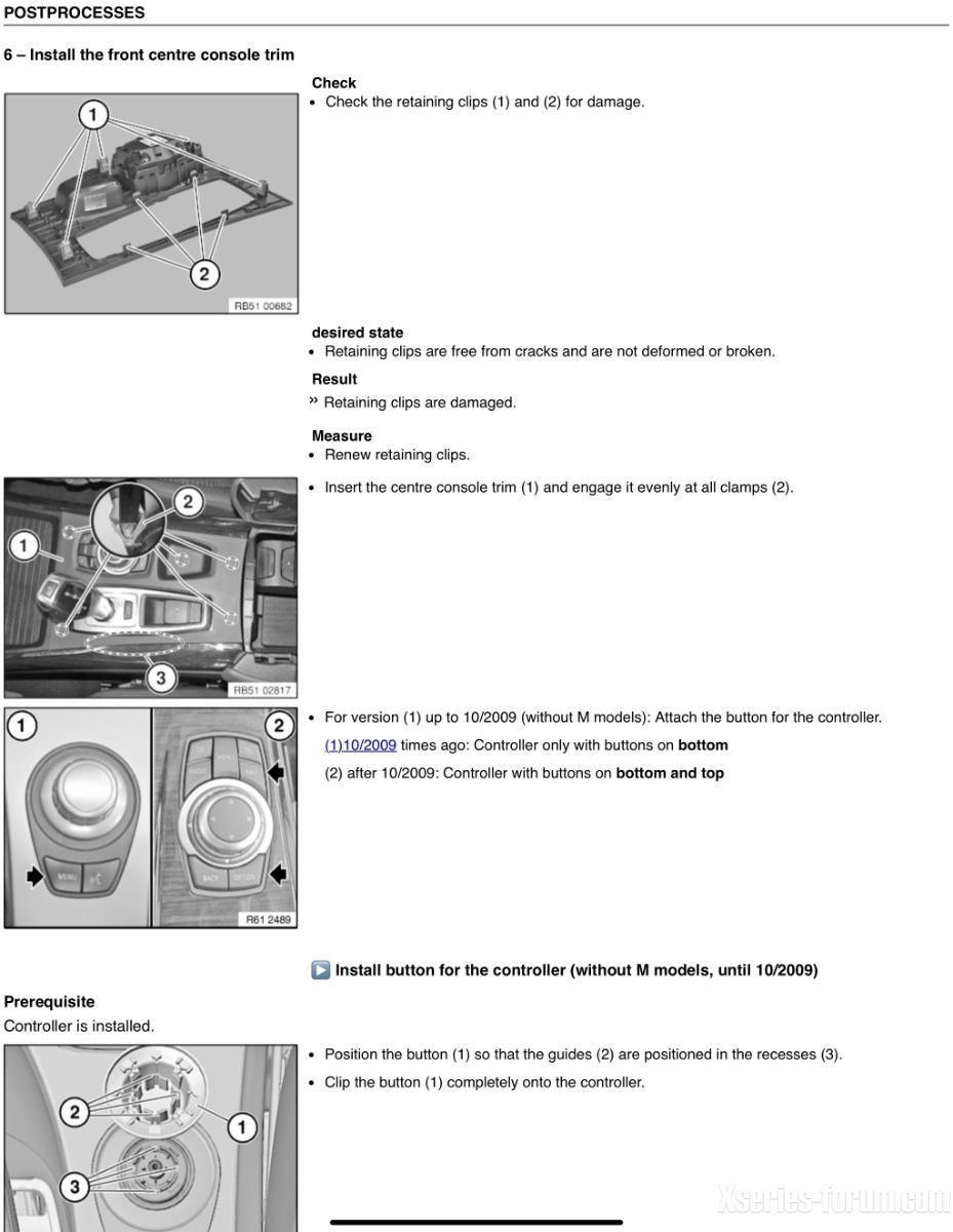

Instructions…..need to dis the battery first! If BMW broke it, shouldn’t they be fixing it? Do you need to take it all out?
Selector trim in next reply….

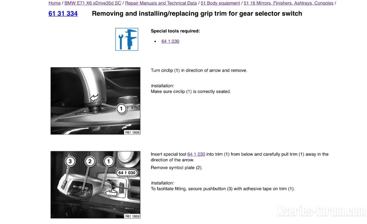

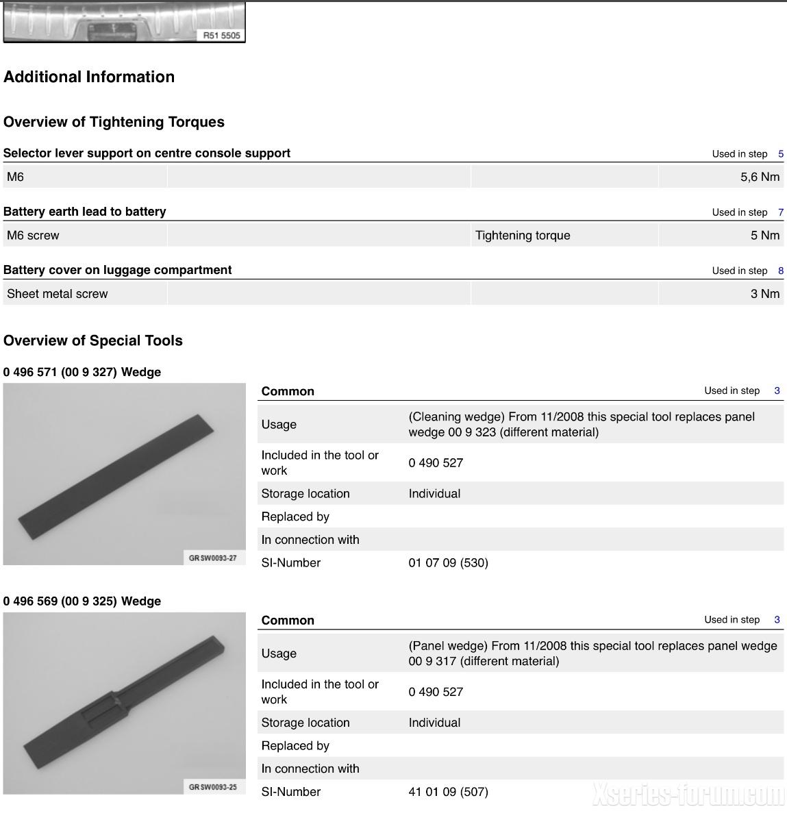

Selector trim:

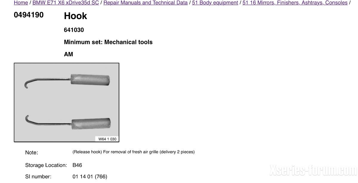

Special Tool (bent wire):

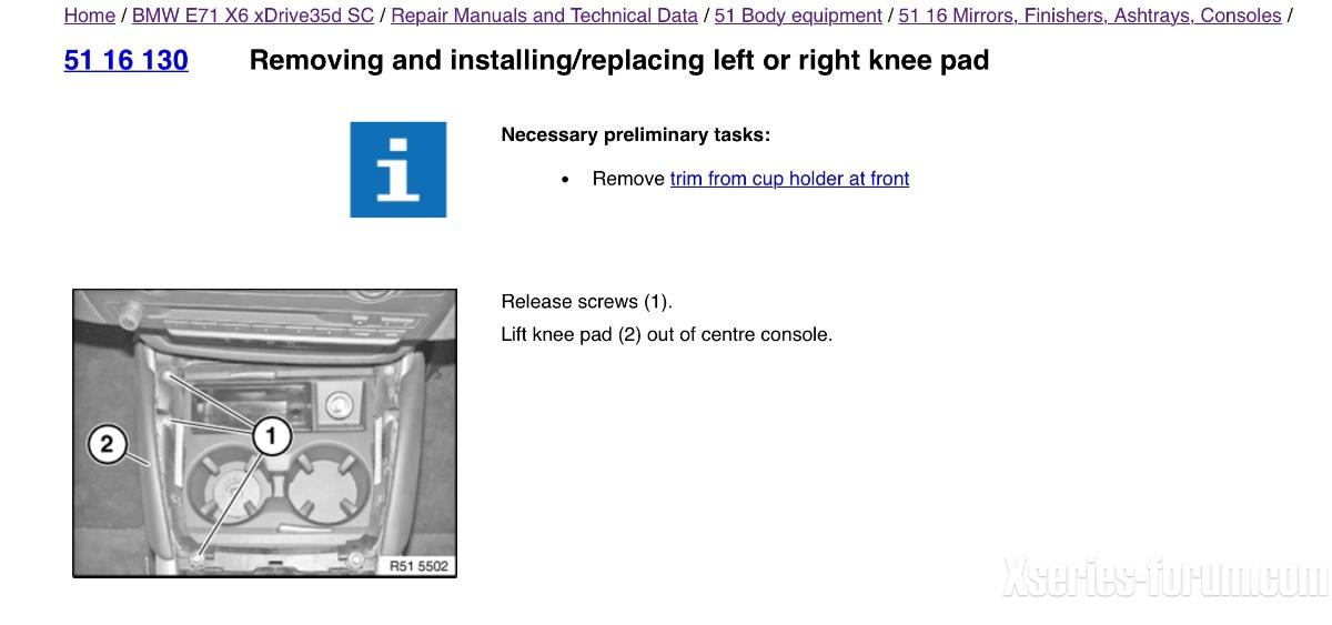

Knee pad….
Special tools are trim removal tools you can buy pretty much anywhere.
