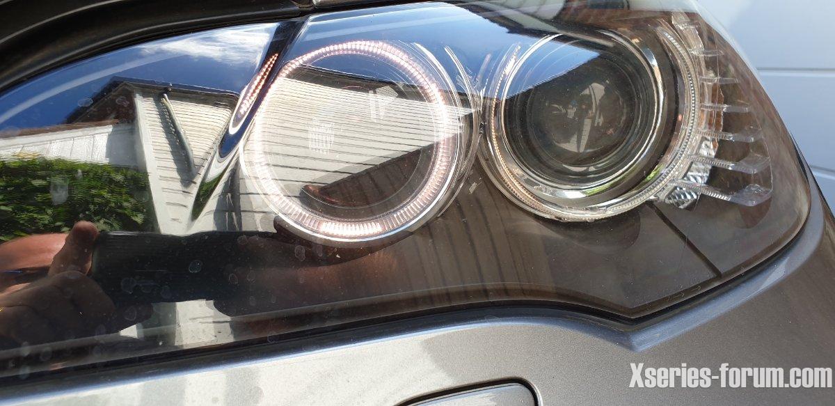

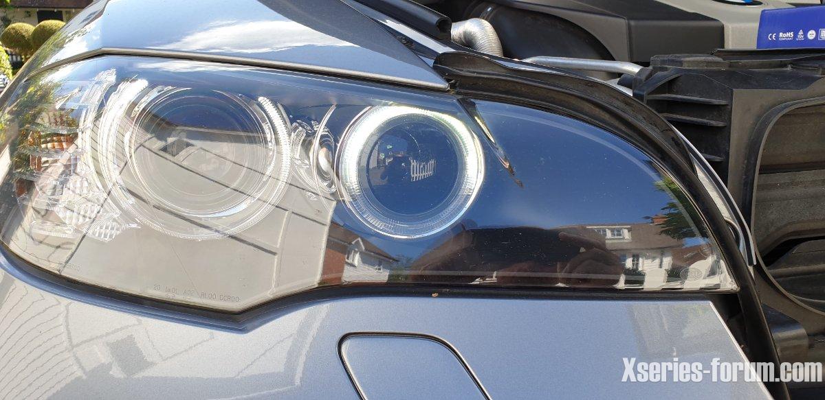

Oh well, not really surprised that these disappointed
. Pictures in daylight aren't the greatest idea, but for the money and the literal pain in my hands created in fitting just one side, its not worth the money or effort. They will be returned.
