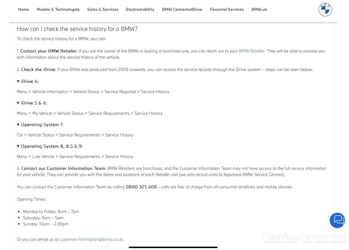

Post by X5Sport » Sat Feb 22, 2025 6:33 pm
Instructions from BMWs own website…

Post by sapphireblack » Sat Feb 22, 2025 6:37 pm
Thank you, above and beyond once again. I just need to establish the cars capabilities to make use of this information.
