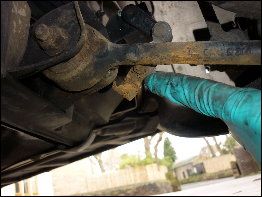

I had an issue last week where the self levelling Xenons were pointing too low. There is no adjustment inside the car.
Whilst changing the pads today, I found the culprit. There is an automatic `adjuster` on the driver side front suspension, this must take the ride height into account and set the Xenon`s accordingly. This had become detached from the suspension and was in the lowest position.

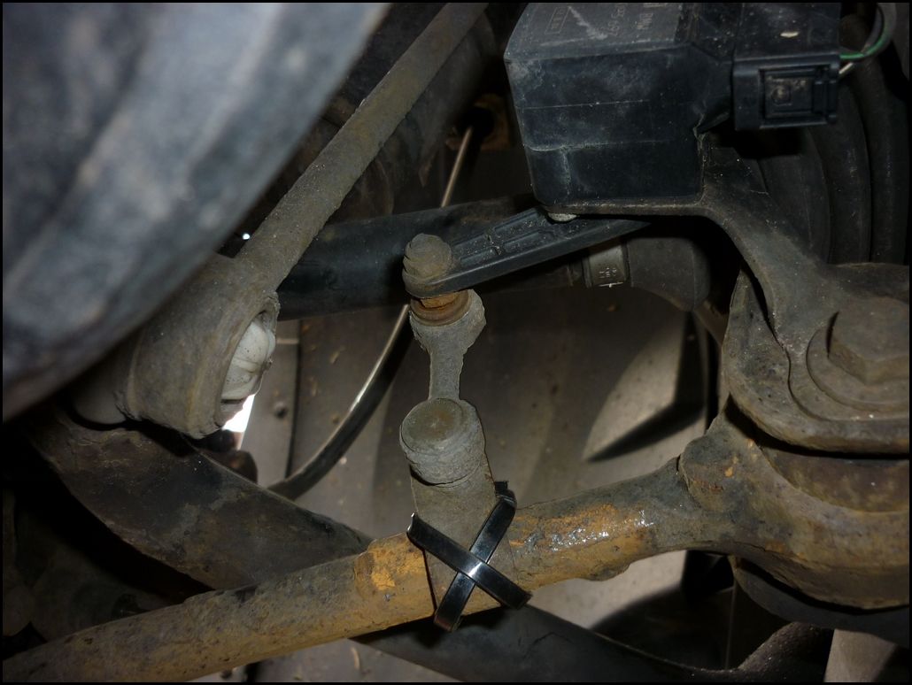

Drivers side wheel removed, this sensor should have the arm secured to the arm

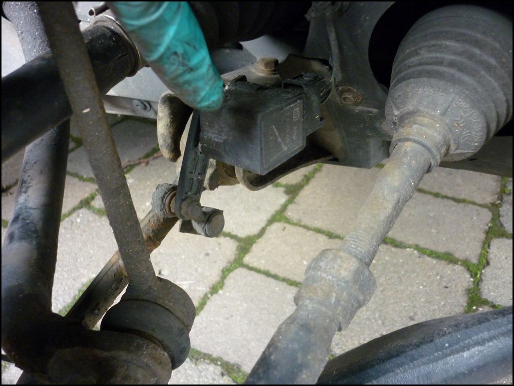

Seen from the back

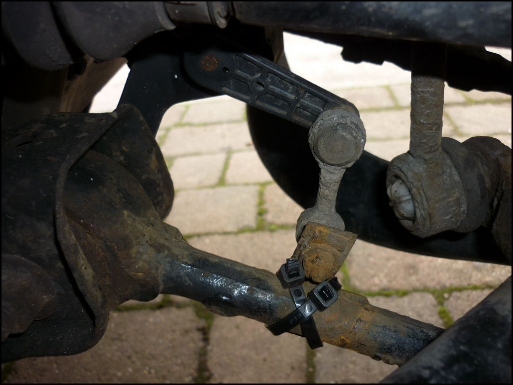

The `sprung clip` had lost its spring. 2 Cable ties did the job. Its under no load, so this isn`t a problem. obviously, you could try and bend the clip or buy a new one, but this worked for me.
Worth a quick look if you are having issues with the Xenon beam height :thumbsup:
