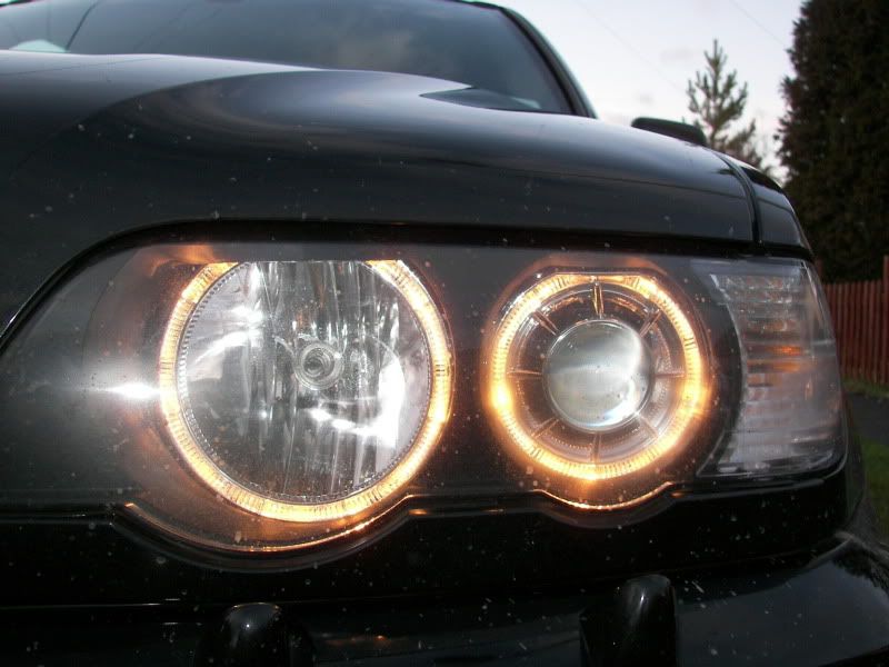

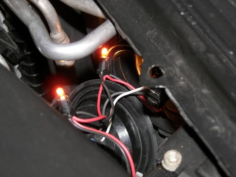

Any way, BIG hi to everyone and my first (of many posts i hope) is about Angel Eyes, However brfore i look for the correct upgrade option, i need to know what type i already have. Looking from outside they look patchy and dull and when i looked inside i found a line of bulbs placed every 60 deg or so, a method i have not seen before. i may add the light units were replaced last year and i think the ones removed did not have angel eyes. The bill for it was £850 for both. And for this it got unusual Ang/Eye
Obviously i want to have Whiter/Brighter angel eyes but cant find a path without knowing the existing ones.

View on outside showing patchy eyes
view showing line of bulbs inside

your lights are identical to mine and they can be changed to leds no problem at all i think they are a t5 model bulb ( cant quite remember will check now ) :headbang:
edit
:thumbsup: yep t5 around £3 to do the lot :thumbsup:
