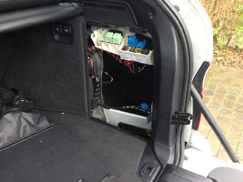

Loading the boot up on the 27th something compelled me to look in the right cargo compartment in the boot. 1 inch of very clean water sitting in the bottom!

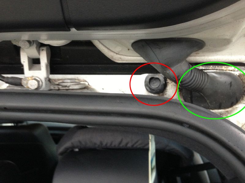

In that instance I found that the wiring loom rubber at the top of the tailgate was hanging loose (circled green below). Refitted it and had no trouble with water again – or so I thought!

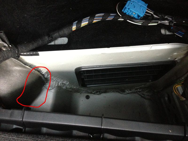

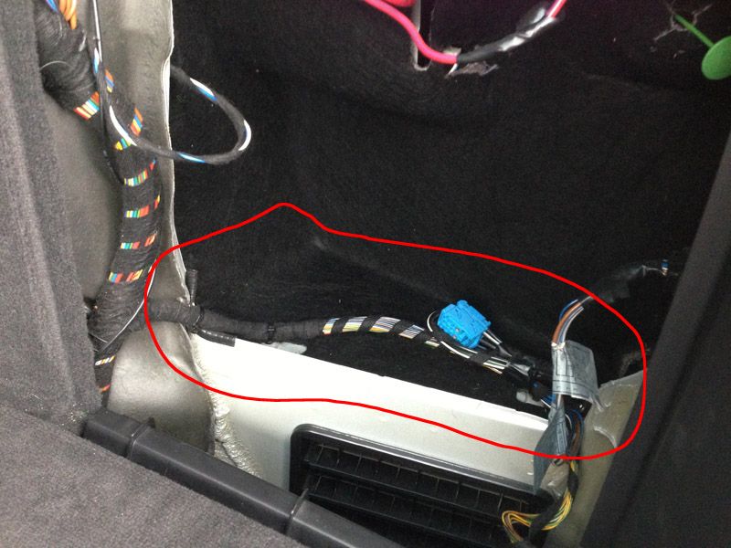

Water had collected in the base of the welled area again (inch deep) and the little carpeted shelf above it (Circled below) was sopping wet.
Water was also dripping slowly off the foam sound proofing marked in the picture below.
The wiring loom rubber is firmly in place - so I scoured the internet for other answers.
It seems that the rear sunroof drains can cause problems. They exit beside each of the wiring loom rubbers at the top of the hatch back (Circled red above) and can get blocked or even detach inside the headlining – eek!
