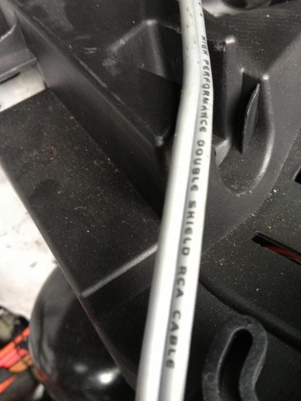

was cleaning the car earlier and found a plug in rear passenger footwell...

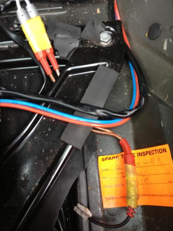

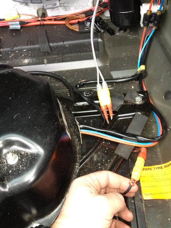

I then took the boot apart and found the following RCA lead plugged into another lead then that was plugged into another lead that went into one, then it dissapeared under the spare wheel base and i didnt have time to unbolt it all and see, any ideas???
RCA lead coming from the rear seat
the leads plugged in together..

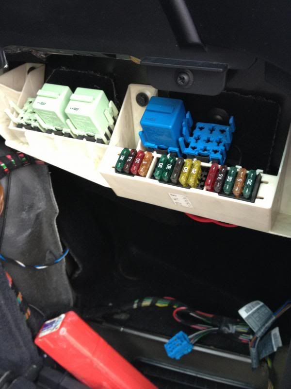

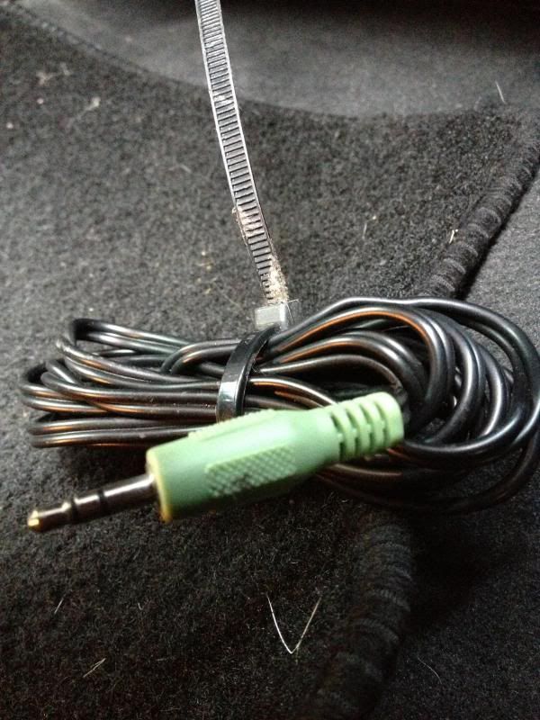

Also what are these??
and this blue plug for?

1st pic-
2nd pic-

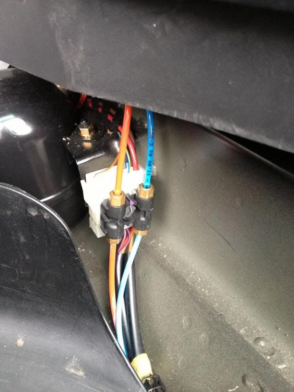

3rd pic- air suspension air lines one left one right
4th fuse and relays as per labeling

2nd pic-could be phono leads for aftermarket amp? maybe

Cheers Shadrack, I thought it was the air lines but wasnt sure.
The last pic i meant the blue plug that wasnt plugged in on the bottom of the pic.

Post by shadrack » Sat Mar 30, 2013 8:29 pm
[quote="Jamee"]
[/quote]
oh lol, it will be for something thats an option, i think there is one standard loom fitted to all cars so the wiring is there to add/remove options at will, is the first pic maybe to plug a mp3 player or something altho wouldnt know as im not into ipods etc

I think it is something like that, but dont understand what tho as the green lead goes into rca leads that go into 1 lead then disappear under the dome metal centre. I dont think there is a amp under there is there???

[quote="Jamee"]
[/quote]
might not be amp wiring as it goes into one, under the metal dome is the battery and all the units for the tv etc as well

1)
3.5mm jack and the RCA lead looks like its being used as an audio input to the headunit (av channel on the TV module). Plug it into your iPhone. **Just a possibility/thought**
2)
Air lines for the rear suspension.
3)
Blue plug is for the rear switch for electric reclining motors for rear seats.

so if i plug an iphone in it should show up in av channel. What about if i plug an hd and media drive into it?
i just think its an odd place to have an input lead thats all.

[quote="Jamee"]
[/quote]
I think so.
[quote="Jamee"]
[/quote]
Agreed its an odd place, hence why a thought and possibility as opposed to complete certainty. Just the only thing I can think of its use for. It's certainly an audio connection for sure.
