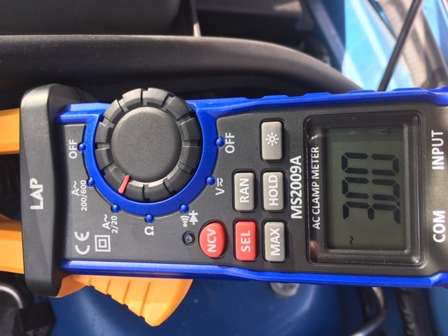

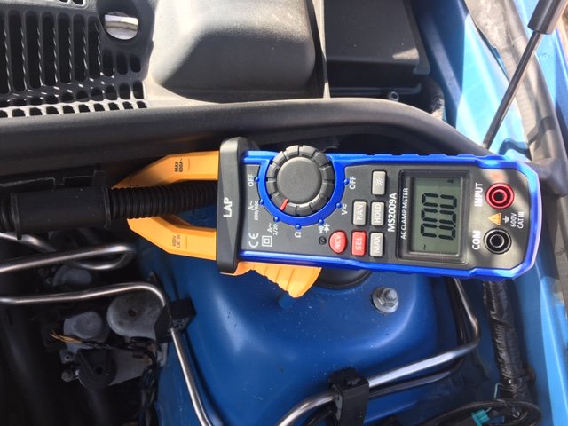

Just done a very quick check with the clamp meter, first picture shows with engine running
Second shows with the engine is off.
I then thought it might be a dodgy bonnet sensor or something, so I set the alarm with the bonnet open and nothing happened, as in, no warning etc. Should there not be a warning to say something is open.
I did the same with the door, set whilst it was open, same, no warning .
I then alarmed the car and opened via the key and the alarm sounded as it should.
I find that all a bit strange that I'm not getting a warning about something being open.

You might have to get one of those adapters so you can check the current draw on each fuse way, after the car has gone to sleep after 16 minutes.
I take it the little orange light by the gearstick does go out?
I think X5Sport might know about how to do it, I’ve defined seen it described on the forum before, there some way of doing it without waking the car up I think
Not sure about the alarm thing to be honest, when I locked mine with the bonnet open and the charger connected I don’t think it made any objections or warnings

Id bypass the bonnet sensor as these used to be a favorite for setting the alarm off on other bmw's
It seems it only goes off when the alarm is armed so locking it manually at night may be the way forward for now .
Re: Battery drain?
Bonnet switch is a very common culprit on the E53. They get wet and corrode inside which causes problems. Asleep the car should be less than 100mA depending upon what options are fitted. Some can be below 80mA.
I don’t remember my alarm going off if I locked the car with the bonnet open, but it would go if the switch was touched (reacting to a changed state from when armed). Two presses of the key fob lock button disables the interior sensor - in case that might be the issue?
