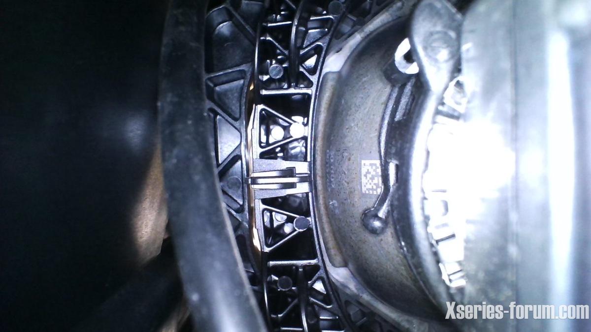

Could i trouble you, when convenient, to tell me what page that scan is from? I can't find a Driving Precautions heading in the index of the manual i have. Though 2009 30d and an LCI 40d could be different i cant see any levers in the picture i took of the right side low beam unless its the sort of highlighted item with 'two eyes', i cant imagine how that would slide?X5Sport wrote: Sun Mar 23, 2025 11:08 am I’ve found this in the manual for the E70/71 for halogen headlights. I don’t remember coming across a lever in the Xenon lights, but the manual says it’s there. The manual is a PDF that covers all models (including other parts of the world). The E70 is top left. I’m not sure the X6 ever came with halogens. I believe, but am happy to relearn, that the idea behind the flat beam fitted to Xenon type lights avoided any need to change. I would have thought that just adjusting the beam heights might solve the issue….if there is one?

Page 150 of the BMW On Line manual that downloads into the BMW Guide App. Publication date is August 2010. That’s from before when my X6 was built so must have been the correct version at the time. The on line manual covers all versions and all markets for E70 & E71 as well as the X5M and X6M
You might find it in the printed version under ‘Driving Hints’ as that’s the section it appears in.

Curious indeed. The handbook with the car is bereft of pages 150, 151, those are actually the double page introduction to the Navigation section. Things obviously got changed/updated.
I have finally gained access to the online manual, which I will bookmark.
I think my photo does seem to show the adjustment thats visible in your screenshot. I'll have to try some experimental sliding.

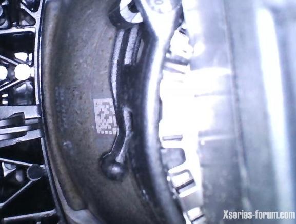

Managed to find the lever for mine. It is right at the back of the projector itself, so as far forward as you can get in front of and above the actual bulb. I can only see it by using an endoscope and I’m not sure that my large hands can get in there! I’m probably going to have to remove the Xenon bulb itself in order to give me any room.
Why in earth they put it there and restricted access with all the support structures behind it, only BMW will know.
It’s a do it by feel job without any doubt. No chance of doing it visually.

It’s the black lever on the left side of this image. It’s actually on top of the bulb so rotate the image clockwise 90° to tell you where it actually is. In other words Left in the image is the top on the car.
This is on a Xenon car. The E70 doesn’t need adjustment but the X6 with bi-Xenon does. The inner light is fake and for show as we know.
