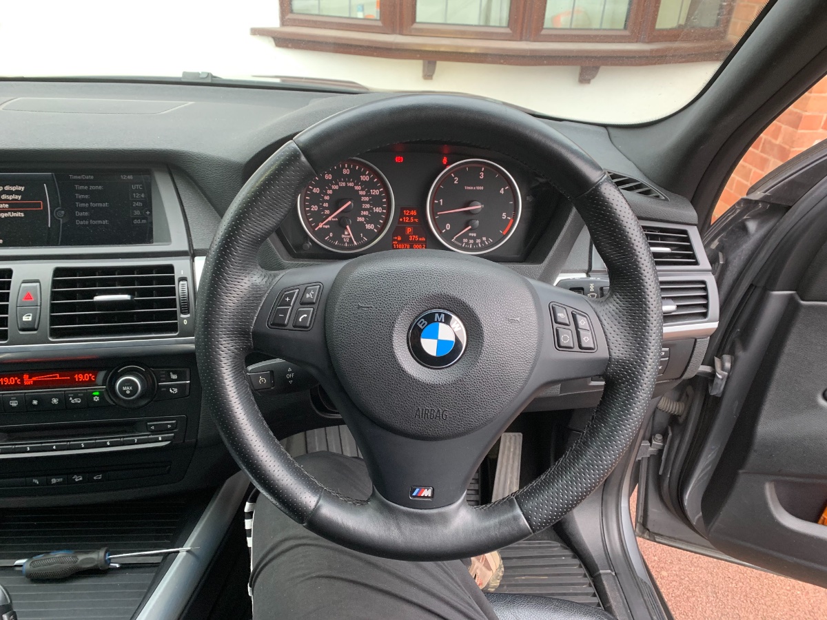

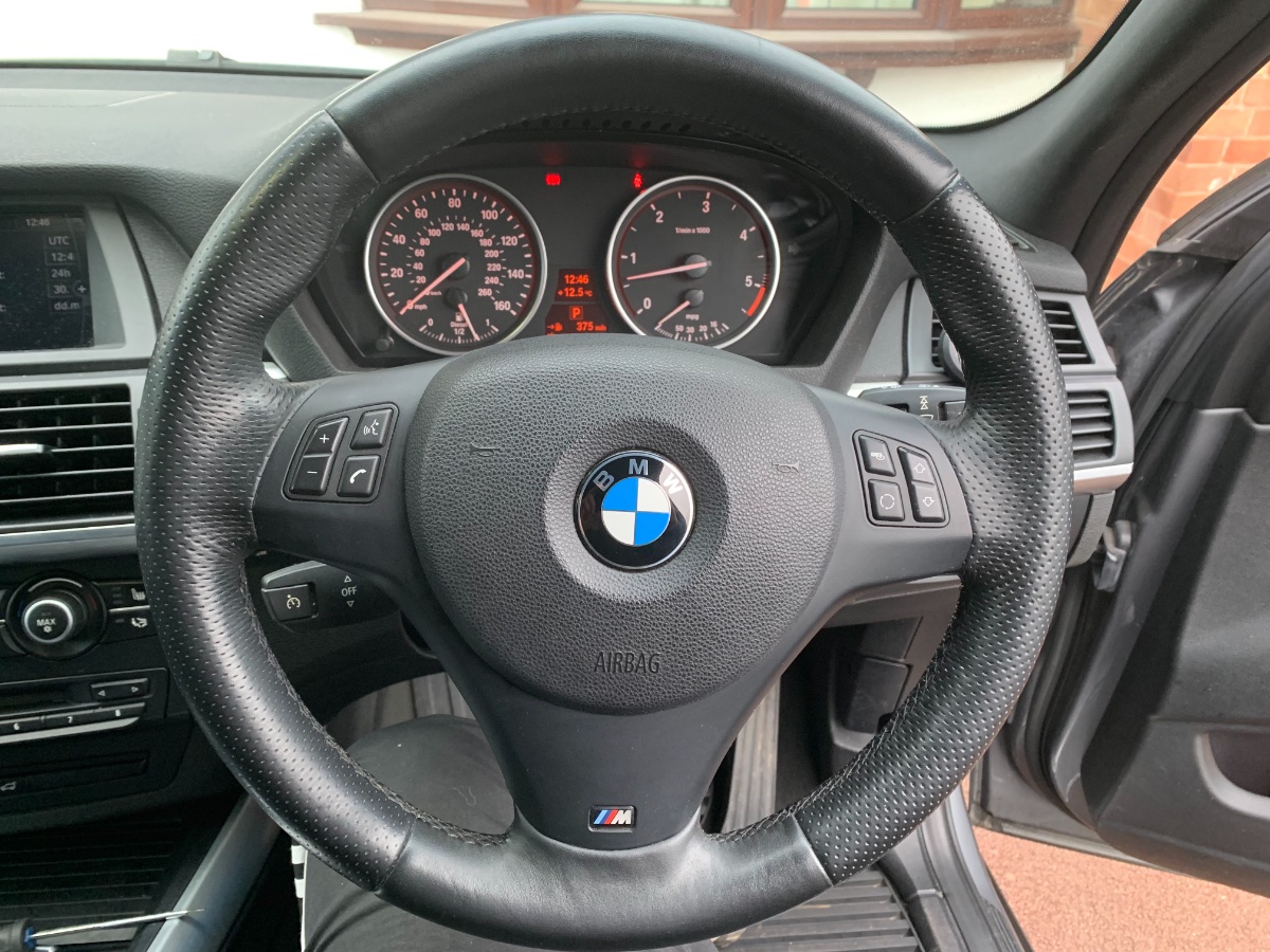

Post by Digidick » Sun Dec 30, 2018 5:20 pm
The 3 Series and 1 Series M Sport steering wheel is a straight swap and with it being slightly smaller feels great in the hands.

They might be very slightly thinner but feel better in the hands especially around the 10 & 2 o'clock position. I might consider having it re-trimmed a bit thicker in the future.

Yep it plugs and works, takes 10 mins to swap.
