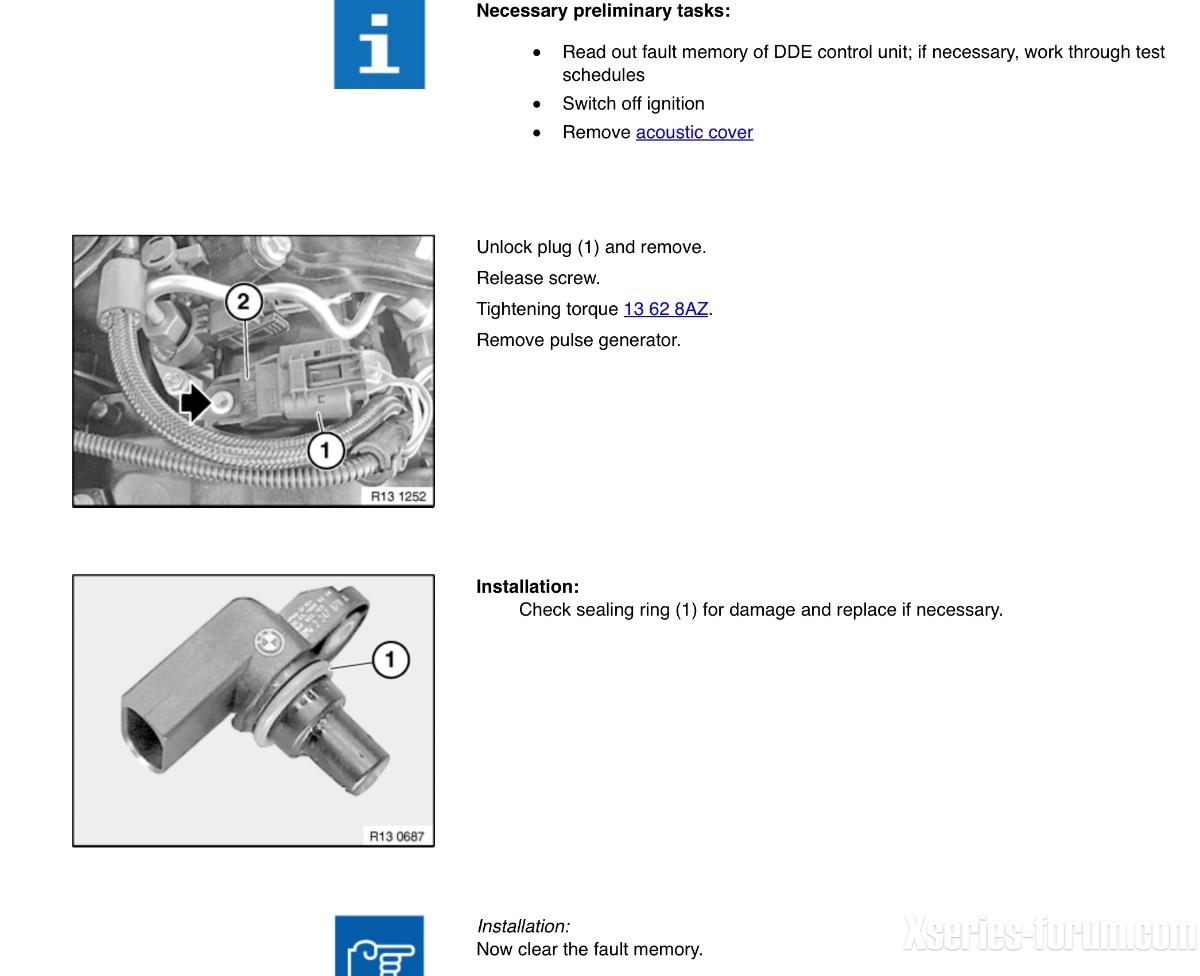

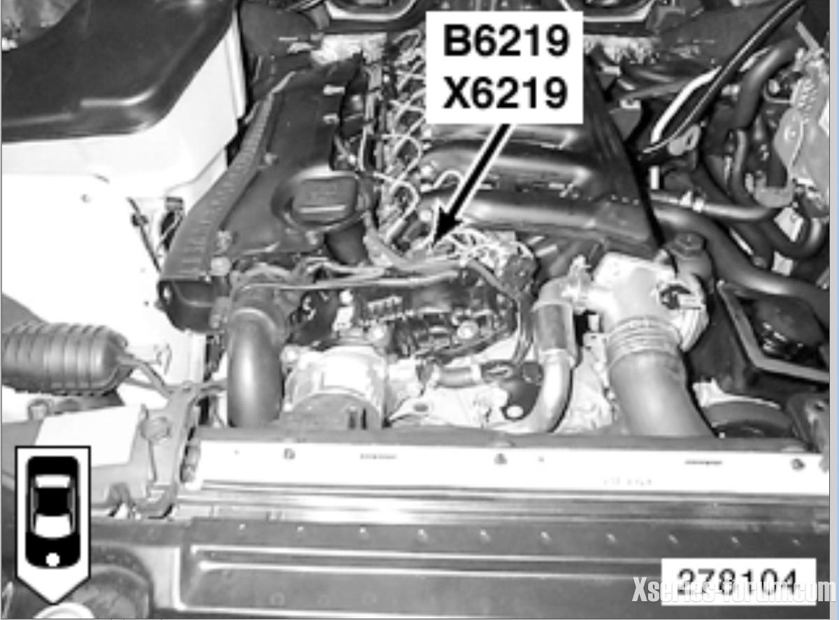

Post by X5Sport » Thu Feb 16, 2023 7:17 am
This help?
Numbers below are for the Hall Effect sensor and connector.

Post by Al4693 » Thu Feb 16, 2023 8:09 am
That is very helpful. Thanks both!
